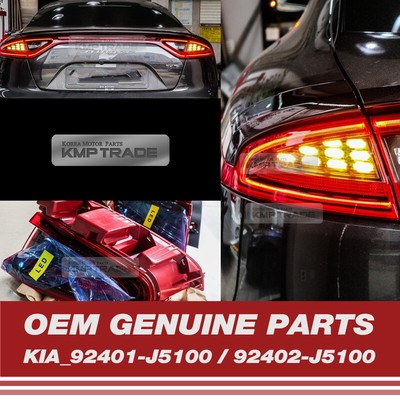

Mine is a 19 GT2 and they were pnp, no wiring at all. The new center piece you will need to widen the holes for the bolts. Not sure why they changed the bolt location. The hardest part was getting the 2 outers top color matched piece off, to move it on to the new ones. Watched videos but it was a pain. Ended up breaking couple tabs on each but its secured. My hand is on the new one. You have to trim the 2 tabs on either side.

Yes, installed them myself. Another set of eyes is nice or mod day but it's nothing to difficult. Drilling holes bigger to fit new bolt pattern, taking the outers top colored part off to move it over is hardest part. There was nothing to do with wiring AT ALL. Full pnp and everything worked as it should when comes to wiring. I didn't add anything trim or cut anything, pnp 100%. There's a Korean how to video and it shows his with something wired up to outers, so that worried me as I was hearing/reading both. Saying you had to do some wiring and others saying no. But again nothing to do with wiring at all for me. 100% pnp on all 3 parts! Sequential worked fine, brakes lights fine, lights on was fine, reverse lights fine. Everything.

Like I said he shows some wiring on the outers. I did not have to do anything with wiring at all, 100% pnp. This is basicly the install and how they look at the end when he test. They do not hyper flash, work normal.
Don't worry about the wiring, pnp no hyper. This one shows taking the outers top part off.
