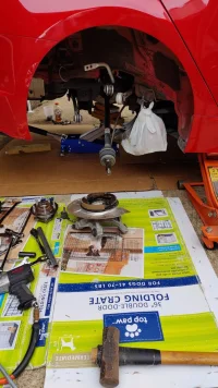

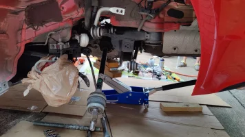

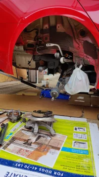

I wish it were an electronic LSD, like on Camaro 1LE and Blackwings. This is a purely mechanical LSD. No reprogramming necessary. Not really any special tools, though you might need a sledge hammer or gear puller to push the 1/2 shaft off the wheel hub splines. That was a Bish! Once you get the 1/2 shaft off the splines, you simple pull it off the diff. Prybar might help, but it basically pulls straight out.
Lowering/raising the diff requires a floor jack. A helper would be a very good idea. I had my son help me, which was great.
I had to replace the rear splash shields at the same time. You won't need to, so you just need to remove enough control arms to swing the drive hub out of the way.

The LSD came from a '21 G70 6MT with only 12k miles on it IIRC, so it looked pretty much brand new. Seals were in excellent shape, so no need for new ones. It was a straight swap. I did change out the gear oil with Mobil 1 and Valvoline synthetic 75w90, with a few Oz of CRC TransX additive mixed it.

The blue jack shown above is actually our "travel" racing floor jack . It's lightweight aluminum and we typically take it to track days and AutoXs. I've got several other floor jack actually, included several motorcycle floor jacks. I actually started out trying a flatform style motorcycle floor jack, which I though might be better for this purpose. Ended up, uh, not so much. The blue "racing" jack proved easier to modulate/balance. It is only holding the weight of the diff... nothing else. I had my son, so that helped the most.
