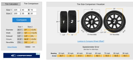

That's quite a jump in wheel size from your OE setup. Your tire aspect ratio is going to be very "rubber band tires" in order to maintain the same OD within less than one percent difference.

Ya AWD . Came with the staggered 19" 225/40/19 + 255/35/19and a set of aftermarket 18" squared 225/45/18

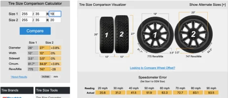

Speedo will not be terribly off, maybe .5 miles or less, depending on the size tire you choose.

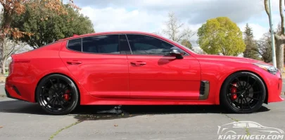

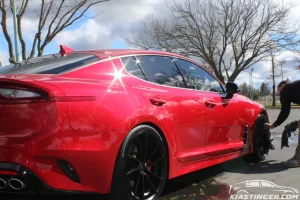

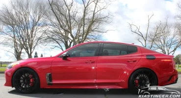

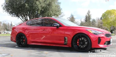

This guy is 20x9 + 38 255/35/20 squared. I like how it's not too aggressive. I just trying to find out how much my speedo will be off and if I can live with that.
Don't lose sleep over the speedo. It will be minimal maybe somewhere around 1-2 mph.
