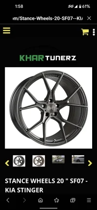

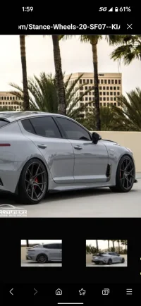

Im RWD and I'm in deep ordered the rims with those offsets their custom drilled for stinger so no hubcentric ring and ordered tires attached there's a picture of the car with the same offset so I'm hoping it'll work it's from Kars Tuners and they swear by it so we'll see I'm going to hold them to it425316510-Stance Wheels 20 " SF07 - KIA STINGER

The wheels look great, let us know how they look and fit after install.
Something else to note is that the car pictured is lowered. If you're at stock height your amount of "poke" will be different than what they're advertising.

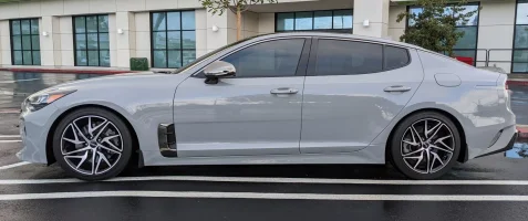

You're also going to still have significant wheel well gap. I went with the same size tires and this is what the wheel well looked like prior to being lowered. Still ready for some light off-roading. The tire sizes you're looking at are roughly a half inch taller than stock so that's about how much wheel well gap you're going to be closing.
Yes I'm lowered what ET off set are you running? Thanks

Those were 9" +35 front and 10.5" +45 rear, iirc.
At +22 you should probably expect some poke in the front, so you won't be disappointed. And if they happen to fit flush you'll have a pleasant surprise.
