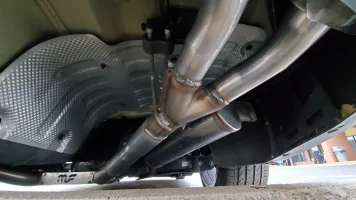

Just had the Magnaflow cat-back exhaust system installed this morning. I had some gear handy so recorded before and after on my Blackmagic pocket cinema camera 4k with sennheiser mkh-416 so the audio is pretty good. I plugged the mic in the camera directly and used phantom power from the camera, so keep in mind the camera doesn't have limiters but it worked out (I have an external recorder with limiters but just wanted quick easy takes). There is a BIG difference in sound so to be clear the audio settings were exactly the same for each take.
Overall I'm liking the sound. Waited a long time trying to decide what to get. I was set on Jun B.L. but recordings I heard on youtube seemed a little raspy in the mid to high range. These sound very deep and throaty and to be honest sound better than the stock 3.3T exhaust, which I'm pleasantly surprised about.
There is no noticeable drone, though it is louder in the cabin than before so it will take some getting used to. Interestingly enough, the higher you rev the smoother it sounds and inside the cabin its not really that loud with higher revs. Outside, though you can definitely hear it.

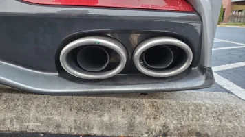

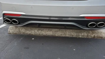

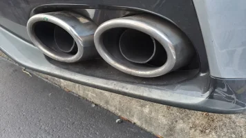

Regarding drone. After a couple days I noticed droning and it was getting louder especially if you're in the back seats. After reading about how people were installing aftermarket exhaust tips and that helping, my exhaust shop extended the exhaust pipes through to the edge of the factory tips and that got rid of all the drone.

I have always wondered why the exhaust pipes weren't in the actual stock exhaust tips anyway, why is there a gap ? someone advised maybe it was to stop any potential vibrations ?

Yeah possibly to prevent the pipe from vibrating/rattling on the bumper. There's a 19 page thread about tips Exhaust Tips discussing this topic. I showed that thread and pictures to the exhaust shop I used and he thought that attaching tips to the exhaust pipe and squeezing them through and touching the bumper opening was the dumbest thing you could do and refused to do it that way. His solution was cutting off the tail pipes at the y joint and welding in longer pipes to extend them.
This is most likely the case. I've got the 105x75mm oval tips for my Borla cat back. They have just enough clearance, maybe 5mm offset all around, to make it through the stock openings in the bumper without trimming, which is how I left them. Since the exhaust pipes don't perfectly center with the openings (and move as they heat up) the tips rub against the black plastic and can be heard rattling from outside once the car is hot and at idle. The rattle isn't bade and doesn't really seem to affect the interior. I've contemplated trimming, but haven't been motivated.
I actually purchased tips and took them to the exhaust shop but he refused to install them for two reasons: first because he didn't want to trim or alter my bumper and second he said he was certain it would rattle so he recommended the extensions. It solved the problem but it does look a little weird.

This actually makes me wonder why Magnaflow didnt make these longer to begin with to extend all the way to the back.
