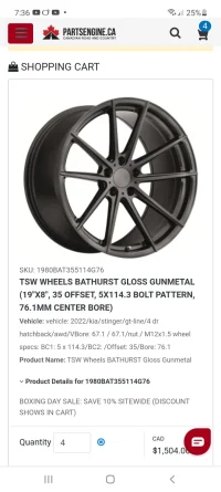

Darren1556 Newish Member Joined Feb 27, 2018 Messages 9 Reaction score 8 Points 3 Dec 31, 2021 #1 Looking at TSW Bathurst...they only offer 19x8 and not 19x8.5 as I was hoping for the rear. Anyone running stock rear tires 255/35/19 on a 19×8 wheel?
Ohiocruiser 1000 Posts Club! Joined Sep 10, 2020 Messages 1,879 Reaction score 1,396 Points 118 Dec 31, 2021 #2 You want at least 8.5 rim for 255 tire. Tire shop might even refuse to install the tire on that rim.
DoctorStiches 1000 Posts Club! Joined Jan 28, 2018 Messages 1,139 Reaction score 764 Points 118 Location Woodland, WA, USA 98674 Dec 31, 2021 #3 Current for winter - 245- 45 front 265- 35 rear on stock wheels Summer set - 245-35 square on 19x9 +22 wheels they fit fine!
