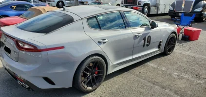

I went with the following for my "2nd set" (ended up destroying the OEM tires at an auto-x skid-pad, still trying to figure out what to do with them, whether to get new tires, or sell them, or what). Enkei TY-5 in gloss black. IIRC, the weights are tire weights.
245/40-18 653.2 (-1.21%) 23 lbs 18x8.5 ET+35
285/35-18 656.7 (-0.7%) 27 lbs 18x9.5 ET+35
Noticeably lighter than OEM - the 285s on the wheel are about as heavy as the OEM 225s.

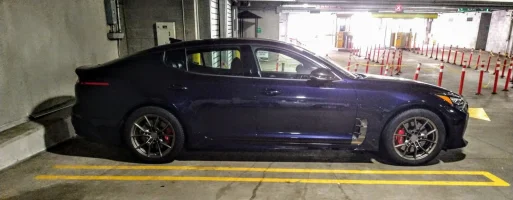

I went with 18" square 8.5s with 255s, so I can rotate them around completely.
Your car looks great! And I agree with you about big wheels. 20s don’t look good on the stinger to me. They look too big for the car and they make the brakes look small. Bigger is not always better.

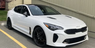

Already stated here by others but better durability, ride, weight and price also straightline traction may be better as well.IMG_20210806_154224219~2.webp Personally i like the look better too. The sidewall stiffness on our 19s is a demishing return imho. I can get similar performance with a slightly taller sidewall on the 18s. Its not like we're downgrading to 15s or something where sidewall flex is super noticable.

Already stated here by others but better durability, ride, weight and price also straightline traction may be better as well.View attachment 64002 Personally i like the look better too. The sidewall stiffness on our 19s is a demishing return imho. I can get similar performance with a slightly taller sidewall on the 18s. Its not like we're downgrading to 15s or something where sidewall flex is super noticable.
what wheels do you have? Fellow Indigo owner here, thinking of downsizing to bronze 18s
