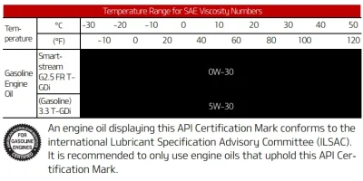

The only oil recommended is 0W30 for the GT-line in the 2022 manual. That's what I'd use.
They have changed over the years
The 2018, 2019, 2020, & 2021 manual says:
2022, & 2023 manual says:
