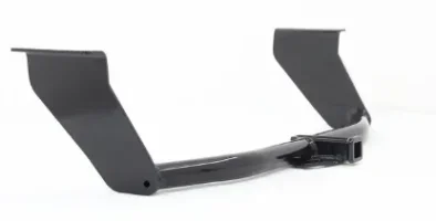

Thank you. Comparing the hitches, there are considerable differences, especially the height difference between the receiver and the top of the brackets.
The Curt C12165, for the 2019 Genesis G80, has high wings:
By comparison, the Draw-Tite 24974, class 1 for the Stinger: has lower wings, and the wings go further back:
