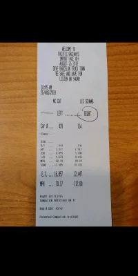

Here is my 12.44 slip again. Interesting to compare the 60 foot 1/8th and trap. Combine my launch and your finish and an AWD could hit 12.2s
You made up more than a tenth in the second 1/8.
